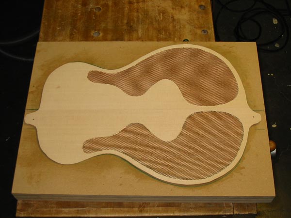

Peter, here's a picture of the way I do my double tops. I wont go into the whole tutorial as I pretty much do it exactly like Alan. Nice photo tutorial Alan. I use slightly less honeycomb than Alan, some people use more like Alan and some use less than I use.
I do however use some heat to help with the curing and bonding of the Nomex to the spruce skins. Not that I've had any problems not using heat, I have it available and it helps with the filleting of the epoxy to the core, so I use it.
My skins are approximatley .03 thick with the core being about .06.
The double tops I've made seem to be very stable.

Jim, very slick design. What you are doing follows with the idea that most of the tone is a result of the lower bouts. Good thinking. I see you are keeping the slip between the bridge plate and the tail block. Is this for anything other than strength issues? The studies in classicals at least seem to indicate that it isn't necessary for the strength of the top and there isn't any more bow-up or curvature to the top over time without it. And on my double-backs I'm doing them full Nomex. Do you have any Chladni modes for this top design? I'd love to see them.
